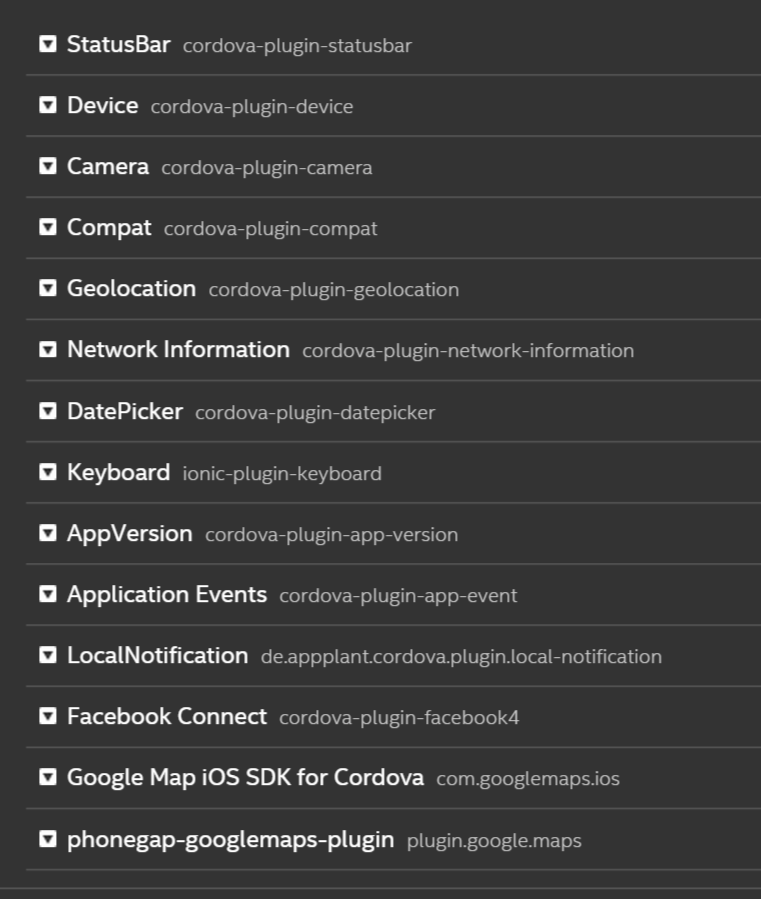

When you actually build your app in Intel XDK, plugin works without any issues.
But when you preview your app in Intel App Preview, you will see blank space instead of the map.
It doesn't matter what type of preview you use: USB, WiFi or Intel server.
Also when you try to debug an app after installing this plugin, you will get error while generating debug module.

This plugin will not work in App Preview unless you build a debug module (in the debug tab). App Preview only contains a set of core plugins. You can see what these are if you launch AP and the do a 5 finger tap on the screen. This will bring up a list of all the built in plugins. If must use this version of the plugin, you most likely will need to build your app and test it on device.
There are some plugins that cannot be built with the custom debug module. To get around that, you need to use remote CDT to debug on a real device. This will work with Android, but not iOS. For iOS you'll have to debug using weinre. Here are some links to help you:
