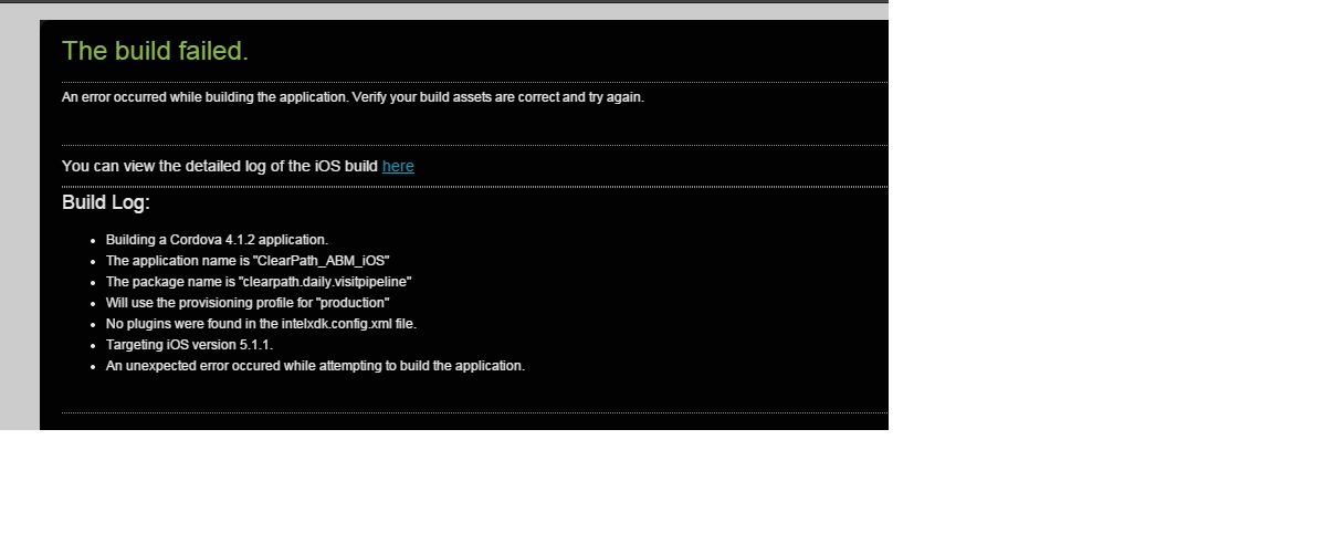

I am new in Intel XDK ios App development. But getting following issue.
Please suggest me a solution. I am trying to solve since 1 week but not solution.
To get complete report you can click here
    /usr/bin/codesign --force --sign 990C64C63A7B3521440C5AF337B79A246F6781C3 --resource-rules=.../ClearPath_ABM_iOS/platforms/ios/build/device/ClearPath_ABM_iOS.app/ResourceRules.plist --entitlements .../ClearPath_ABM_iOS/platforms/ios/build/ClearPath_ABM_iOS.build/Release-iphoneos/ClearPath_ABM_iOS.build/ClearPath_ABM_iOS.app.xcent .../ClearPath_ABM_iOS/platforms/ios/build/device/ClearPath_ABM_iOS.app
990C64C63A7B3521440C5AF337B79A246F6781C3: no identity found
Command /usr/bin/codesign failed with exit code 1
** BUILD FAILED **
The following build commands failed:
	CodeSign build/device/ClearPath_ABM_iOS.app
(1 failure)
Command finished with error code 65: .../ClearPath_ABM_iOS/platforms/ios/cordova/build --release,--device
Error: .../ClearPath_ABM_iOS/platforms/ios/cordova/build: Command failed with exit code 65
    at ChildProcess.whenDone (/Developer/cordova/4.1.2/node_modules/cordova/node_modules/cordova-lib/src/cordova/superspawn.js:135:23)
    at ChildProcess.EventEmitter.emit (events.js:98:17)
    at maybeClose (child_process.js:753:16)
    at Process.ChildProcess._handle.onexit (child_process.js:820:5)
John_H_Intel2
6,517 Views
Your second image show that you have selected a .cer file. This is incorrect. You need to specify a provisioning profile that you get from apples developer portal.
