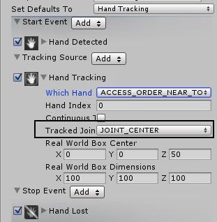

I think that if you need to limit the directions that your cube can travel in then it is much better to use the Toolkit's TrackingAction script instead of TranslateAction.  With TrackingAction, you can set 'constraints' for the position and rotation axes in the Inspector window to stop the object from moving in the directions that you have ticked in the constraints.
For example, if you wanted to stop the cube from rotating up and down then you would place a tick in the 'Y' axis box for both its Position and Rotation settings.
I am guessing that you should first place a tick in all three of the TrackingAction's Rotation settings (X, Y and Z) to stop it from being able to rotate at all, and simply use Position movement in the X and Z directions to get your left-right movement with a little in and out.

Click on your cube to show the TrackingAction settings in the Inspector panel and look at the upper half of the TrackingAction settings.  Expand open the 'Hand Tracking' option and select which body point you want to use to move the cube.  You can leave all of the other settings on their defaults and not change them.

Go the lower half of the TrackingAction settings and expand open the 'Constraints' option.  Place a tick in all three of the lower 'Rotation' boxes and a tick in the upper Position box of the 'Y' axis.
Leave Position 'X' and 'Z' unticked.  X will allow your cube to move left and right, and Z will allow it to sway in and out.

agund4
1,371 Views
Dear Marty,
Thanks for your detailed explanation.
It helped me a lot
