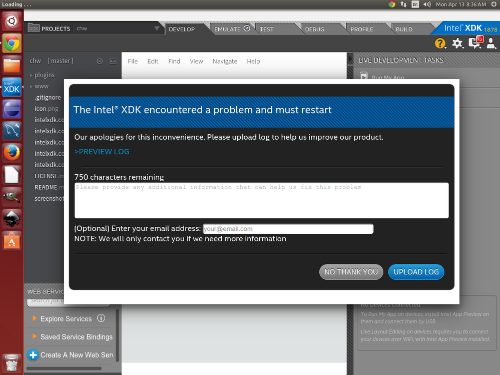

Troy_B_1
3,332 Views
Using XDK 1878 on Unbuntu 14.04 32bit. This error keeps coming up (See screen capture)
Screenshot from 2015-04-13 08:36:07.png
Don't click on the buttons in the dialog because this will close XDK. Click outside the dialog and you can continue using XDK. At least you can use 1878 until the devs fix things.
