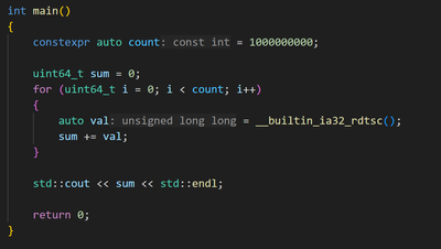

TEST CASE:
assembly of the key code (__builtin_ia32_rdtsc)

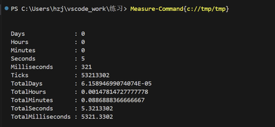

TEST RESULT
AMD(163ms)
Intel(5321ms,much slower than AMD)
