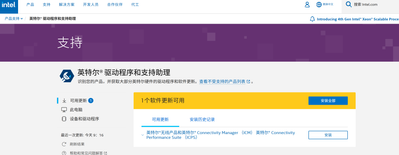

840 Views
英特尔®无线产品和英特尔® Connectivity Manager (ICM) 英特尔® Connectivity Performance Suite (ICPS)更新驱动报错信息如下:InstallShield Wizard
An invalid condition was encountered:Error: 0x80004005
The setup will now abort.

我的无线没有问题使用正常,就是正常使用软件英特尔 ® 驱动程序和支持助理更新驱动,但是安装无法更新报错

Thank you for this confirmation. Please check the reference article below, to proceed with the following steps to uninstall Intel® Connectivity Performance Suite software from the PC or to Downgrade to an older version of Intel® Connectivity Performance Suite software.
How to Uninstall or Roll Back to an Older Version of Intel® Connectivity Performance Suite Software
You may download the latest of the software below (40.25.6141):
Intel® Connectivity Performance Suite (ICPS) for Intel® Wireless Products, and Intel® Connectivity Manager (ICM)
