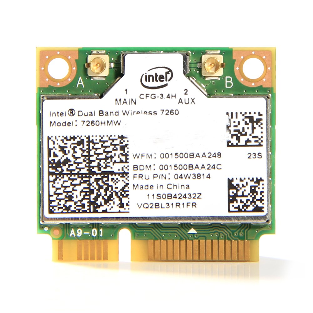

Since you put the card yourself, you get no support from Intel here. Mine was originally included with the laptop with OEM "P/N" printed in the card such as this one: http://ecx.images-amazon.com/images/I/71qv0X58kFL._SL1500_.jpg http://ecx.images-amazon.com/images/I/71qv0X58kFL._SL1500_.jpg. The ones you buy online are generic cards or might be fake, resulting to erratic performance with your laptop.
