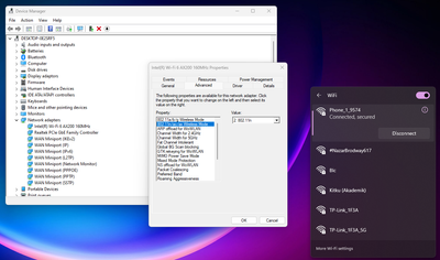

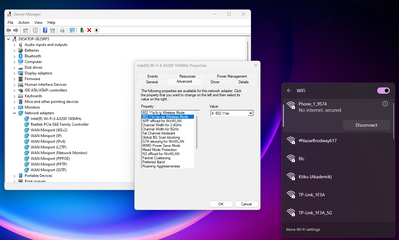

I have a Lenovo Legion 5 laptop on Windows 11 with AX200 network card and Nothing Phone 1.
After last OS update on phone I can't connect to network on 5GHz Wi-Fi hotspot from phone.
I've tried swapping all sorts of drivers, including those listed  at Lenovo website but no result.
Tried on hotspots from other phones (Pixel 6, Xiaomi Redmi Note 9 Pro) - same issue.
Lowering channel width for 5GHz down to "20MHz only" worked but speed is significantly dropped.
The only solution I have now is to change Wireless Mode in device manager to 802.11n.
Is there any other option to use ax?
