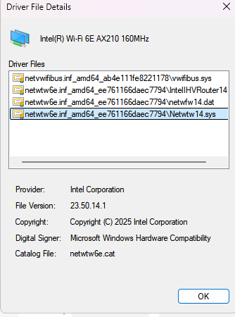

There are no error messages in Device Manager (Device status.png).
However, there are four drivers listed in this device’s properties (Driver1–4.png).

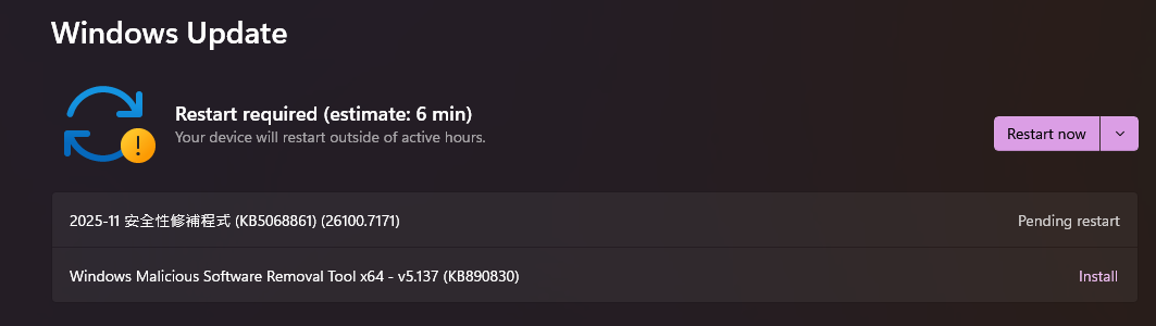

  • Are there any pending Windows updates on the system?
At the time of writing this, yes (Update.png, KB5068861).
When I originally made the post? No.
I wasn't gonna update windows for some time (like 5 weeks)
But when i finished the BIOS update, Windows automatically updated to KB5068861 (I do NOT want to update), I heard there's issue with this update, but I'm not gonna revert it.
If anything bad happens with this update I'll let you know.
