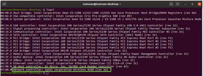

Type the following command to the terminal: # lspci​
Verify that the Intel network controller ​is identified, as on a picture below. If not, then the system doesn't identify the Intel network adapter and you will need to make sure it's properly integrated. You may need to request help from the system manufacturer. If the wireless adapter is properly identified - proceed with the step 3.

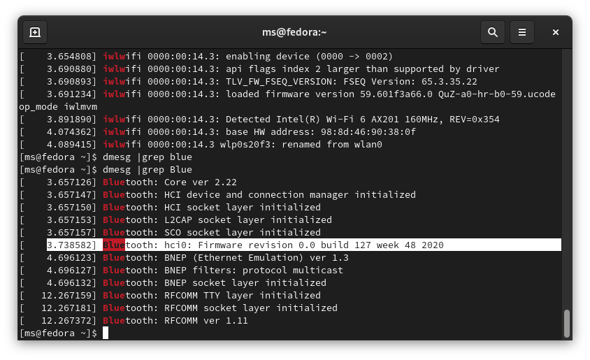

here are the logs where you can see which firmware is loaded. In my case it seems to fit for the integrated AX201. It is a stock NUC, maybe 5 months old. The device is regularly updated (daily/every other day).
firmwarefirmwaredmesg iwlwifidmesg iwlwifi
Although there is a note that the api flags index 2 is larger than supported by driver it seems to me I'm using the latest available firmware. I guess the driver has to be updated accordingly at some point.
