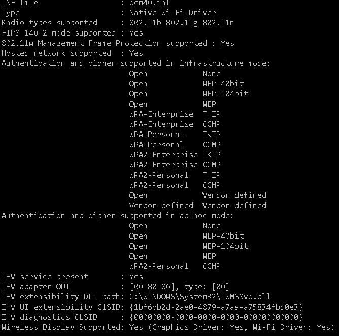

I recently upgraded my internet provider to 5g network.
My Toshiba laptop is not seeing the 5g network only to 2.4hrz.
I have ran a compatibility study image attached
These are the drivers in have
I have tried to uninstall n7260 driver (several times and cleared tem files) and install a dual driver but the N7260 driver wont uninstall.

You have a single band N 7260, not a dual band N 7260.

I know, iv tried to uninstall it and install the dual one. Thats my issue, cant uninstall the original N7260

Your adapter is single band. A dual band driver will not change that.

is there any way to change it

You would need to ask Toshiba about replacing the wifi card. Or, you could purchase a dual band usb dongle.

OK thanks, any idea why the radio types in the image comes back as supporting when is actually doesn't.

Where does it say any of them are supporting 5ghz?
Just get yourself a dual band usb dongel and be happy.
