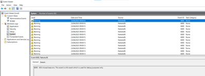

The only issue I noticed with them both - that their System Event Log spammed with the following event: ID 6000 - BSS missed beacons
6000 - BSS missed beacons6000 - BSS missed beacons
Just adding it here as additional diagnostics I have performed. But not sure how to interpret this.

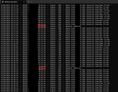

When my laptop with an Intel Wi-Fi 6 AX201 network adapter connects to one of my two mesh TP-Link XE75 APs (not the main AP then it works as expected) I get intermittent network failures that makes it impossible to use for e.g. gaming.
None of my other four laptops or other connected devices are having this problem and I did not have it with my old Wi-Fi router.
Many others describe this problem:
https://community.intel.com/t5/Wireless/Unstable-connection-with-Intel-AX200-AX201-and-TP-link-XE75-mesh/td-p/1523466
https://community.intel.com/t5/Wireless/Does-your-AX201-AX211-work-fine-with-mesh-network-Mine/m-p/1479291
It is easy to reproduce, setup an environment as described above and make a continuous ping to e.g. www.google.com and every 20 seconds or so it will fail.
