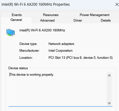

Hi Mike, thanks for replying.
It's a Gigabyte AX200NGW (GIGABYTE G5 KC) laptop.
I downloaded the driver from https://www.intel.com/content/www/us/en/download/19351/intel-wireless-wi-fi-drivers-for-windows-10-and-windows-11.html
There are no errors in Device Manager on "Intel(R) Wi-Fi 6 AX200 160MHz".
