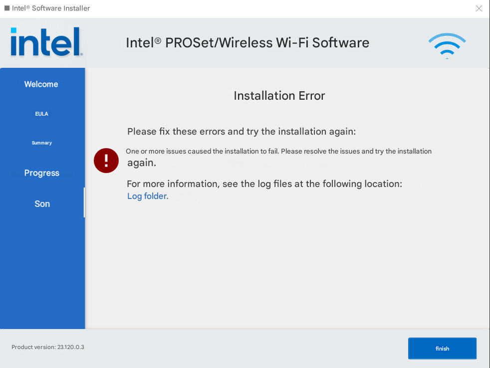

Hello, I have INTEL Wi-Fi 6 AX201 160 Hz hardware. Unfortunately, the latest driver version gives an installation error, but there is no error in the previous version. I did some research on the internet, some say to try directly through IT Administrators. I wonder if there is another way to solve this problem other than IT and what is the normal difference with IT? Do you plan to fix the installation in the next version or this version?
(The system interface I use is Turkish, I translated it to English on the internet for you.)

It may be that the installer has a bug and is attempting to update something that it hasn't established permission for. Have you tried simply running the installer executable As-Administrator? That is, right-click on the installation executable and select Run as Administrator. If you do this and the failure doesn't occur, then you will know that this bug is present.
If it concerns you that an issue like this exists and you don't want to be installing this this way, you can always uninstall it after trying. Otherwise, you simply wait for a new version to be released.
Hope this helps,
As you mentioned, it doesn't work even if I run it with administrator, I will wait for the next version as you said.
It's a bug in installer[error 1607], it's looking for setup.xml package in temp folder which doesn't exist, here's a code snippet from error log:

[3634:12D0][2025-04-06T01:18:45]e000: Failed to parse Setup XML: System.IO.FileNotFoundException: Nie można odnaleźć pliku 'C:\WINDOWS\Temp\{22888F39-0A80-48BE-B41E-B52BC2092691}\setup.xml'.
Nazwa pliku: 'C:\WINDOWS\Temp\{22888F39-0A80-48BE-B41E-B52BC2092691}\setup.xml'

use the unpacked IT/PROset files to install them manually using device manager setup.
Use manual installer[PROset] and device manager to install the update, the setup installer is broken[error code 1607, meaning issue with install shield], it tries to find setup.xml in temp folder and it can't find it.
I've attached the log, because somehow the older post got deleted with log in the message.

Hello Darth_Vader,
After review, I would like to inform you to try and manually install the IT Administrator driver or use the driver from the OEM in case the issue persists on the IT Administrator driver.
If you have other questions or concerns, please let me know.
