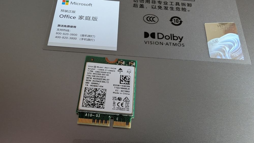

Dear JeanetteC_Intel,
I've been following this thread for a while since I'm experiencing the same issue. Unfortunately, even with the Linux 6.15-rc2 kernel, the Wi-Fi adapter still isn't recognized correctly.
I have the same laptop model - Redmi Book 16 Pro 2025. One thing I'd like to clarify: this model comes in two variants, one with Intel Ultra 5 225H and the other with Intel Ultra 7 255H. The original post mistakenly mentioned "Ultra 7 225H," which doesn’t exist. My device uses the Intel Ultra 7 255H.
To help identify the Wi-Fi module, I checked it under Windows using the driver automatically provided by Windows Update. The adapter is identified as Intel(R) Wi-Fi 6 AX203. To rule out any driver mislabeling, I’ve included the hardware IDs below:
PCI\VEN_8086&DEV_7740&SUBSYS_02748086&REV_00
PCI\VEN_8086&DEV_7740&CC_028000
I also looked up 8086:7740 on PCI Lookup, but couldn't find any corresponding info, which makes me question the actual model. To verify, I physically opened the laptop and inspected the Wi-Fi module directly - I’ll attach a photo of it below.
Thanks a lot for your continued attention to this issue! If you need any additional details, feel free to reach out. I’ll do my best to assist in any way I can. Really hoping we’ll get a solution soon!
