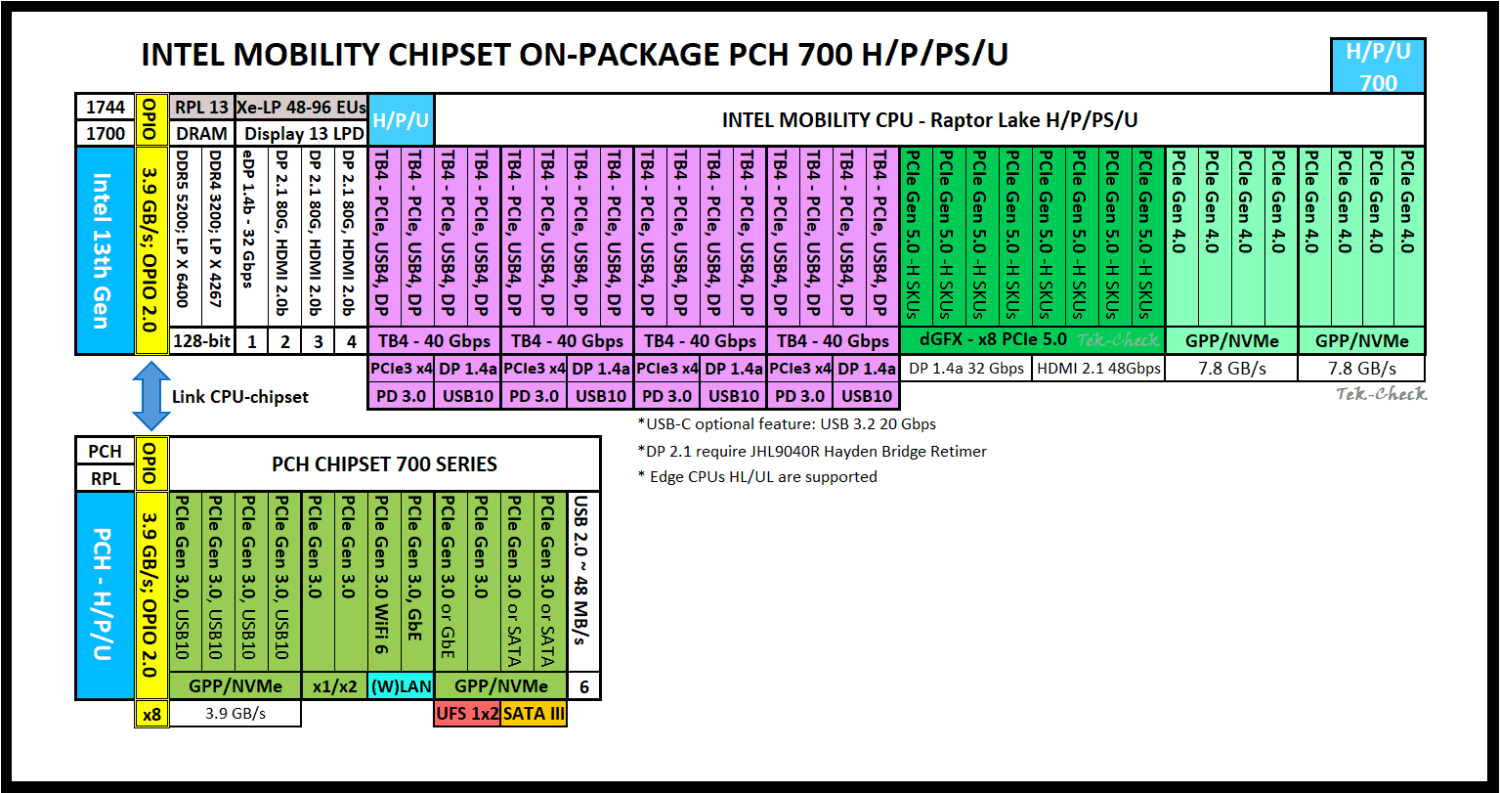

Hello Vinnie & others contributors
Where can you see or what tool are you using to check that your BE200 is connected using PCIe 4.0 x1 ?
"HWwinfo" is clear on SSD PCIe details, but there is no details for BE200.
I'm using an acer Swift GO 16 equiped with an i5-1335U, Techpowerup CPU database shows for M2 wireless : PCIe 3.0 x1.
My understanding is usable bandwidth is 8 GT/s = 8 Gbit/s = 7.88 Gbit/s (encoding overhead deduced) or 0.985 GB/s.
So BE200 connected with PCie 3.0 x1 is good enough to cover default WiFi 7 speed of 5.8 Gbit/s.
However when using WiFi 7 MLO STR (5GHz + 6GHz), total wireless speed goes to 8.6 Gbit/s (6 GHz 5.8 Gbit/s + 5 GHz 2.8 Gbit/s)
In this case it seems PCie 3.0 x1 falls short by 760 Mbit/s, do you confirm ?

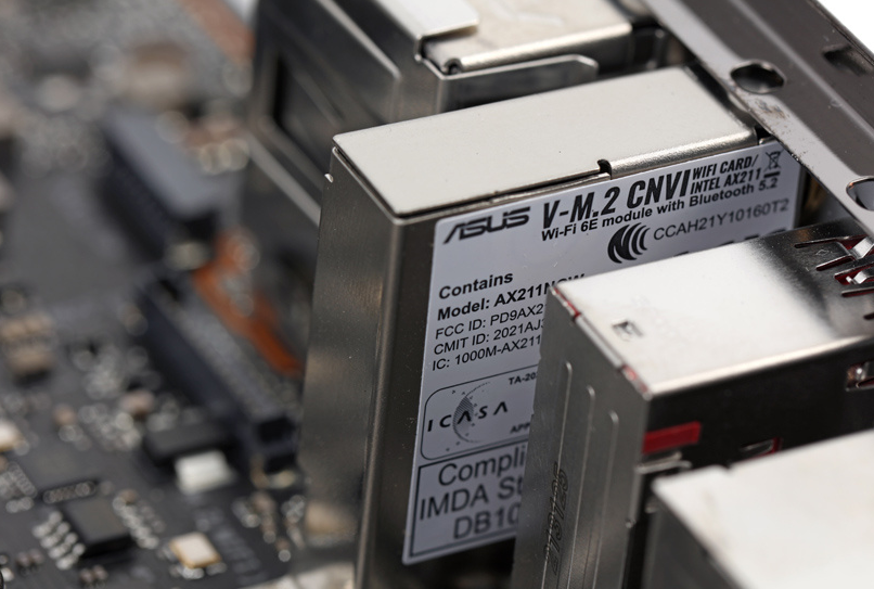

我有一塊 ROG z690 extreme glacial 主機板,內置 AX211 wifi 6E
我可以買 BE200 來替換原來的 WIFI 模組嗎?
- Marcar como nuevo
- Favorito
- Suscribir
- Silenciar
- Suscribirse a un feed RSS
- Resaltar
- Imprimir
The AX211 module is permanently attached to your motherboard and your motherboard does not include a M.2 Type E socket to support the installation of an alternate wireless solution.
All is not lost, however. You can either (1) use a PCIe-to-M.2 WiFi Network Card Converter, such as this: https://www.amazon.com/dp/B0882Z3MKL, to host a BE200 card, or (2) you can purchase a PCIe card, such as this: https://www.amazon.com/dp/B0CW35B4NR, that already has the BE200 module integrated.
In either case, you also need to go into BIOS Setup and disable the onboard AX211 module.
