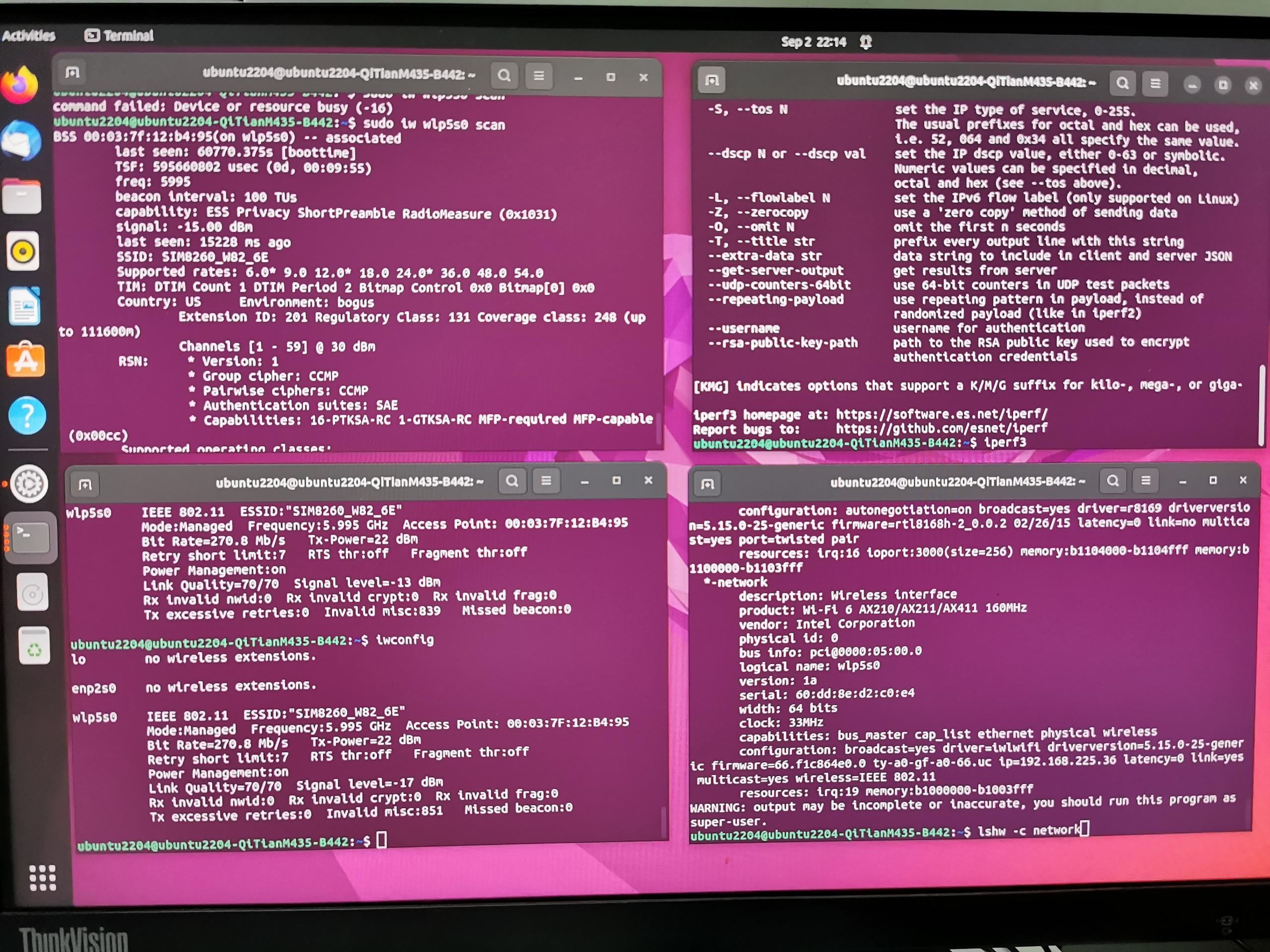

I am using MS Windows 11 pro Insider preview(22H2) with Intel(R) Wi-Fi 6E AX210 160MHz(driver version:22.80.1.1/22.150.0.3). My wifi 6E router is a developing product with Qualcomm chipset WCN6856.
1.If my Router is configured with 6E PSC(Preferred Scanning Channel),AX210 can found & Joined my router successfully.
2.If my Router is configured with 6E Non-PSC,AX210 can not found my router,WIN11 unable to find my 6E SSID. At this time, i use a Ubuntu 22.04 with the AX210,ubuntu can found & joined my router successfully.
I want to know if Non-PSC can work in AX210? Is there any configure to enable Non-PSC or need new intel driver?
Thanks.

After doing some research, I discovered that it is expected that APs in 6GHz will be using PSC channels. I would like to confirm why are you using Non-PSC channels. what is the goal? What are the channels you are using exactly?
On the other hand, you should know that there are scenarios where the Wi-Fi 6E APs are configured to a non-PSC channel, it may take client devices a really long time to discover the Wi-Fi networks from such APs.
Please, test it in a non-insider version and let us know the result and the Non- PSC channels you are trying to use.

in Non-PSC we try on Channel1,9,13,17 and more
because we was under modification with our device with AX210 so would do this test on a difference system.
but should make sure AX210 was fine with HW but we didn't know it was the driver issue or setting on WIN11 so need your support.
also will try on official win11 not insider version.
then response to you out test result
