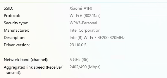

Why my Intel BE200 not support Wi-Fi7?
huahua
2,632 Views
Location: China
OS:Windows 11 Enterprise 24H2 26100.3194
Intel Driver: 23.110.0.5
AP:xiaomiBE70000, QCN6224(not support 6G),  it is wi-fi7 capable, WPA3 encryption
when I connect Intel BE200 to AP, it always work in wi-fi6 mode

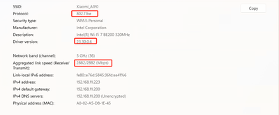

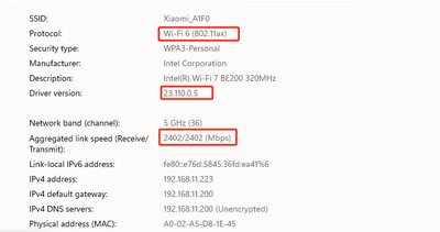

huahua
2,559 Views
Thank you for your prompt reply
Same system, if I use intel driver 23.30.0.6, it can work on Wi-Fi7, But if the driver is 23.110.0.5, it will change to Wi-Fi6.

huahua
2,365 Views
I was trying to enable wi-fi7, not 6G. it is also Regulatory  related?
