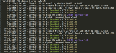

I have been working and testing FTM function using Iwlwifi on intel 8260.
Now, I used below
* iwlwifi driver - core30 backporting, intel firmware version 31.
and iw 4.9 version (already i patched patch -p1 < bef149ad0c1b8c8f.txt)
I have tested AP mode on 2.4GHz (on devices driven by iwlmvm), it is OK.
But, I cannot use 5Ghz band as FTM Respondor.
How can I use 5Ghz band with AP mode?

Hello !
-Basic information
* 0S : Debian GNU/Linux 9
* Kernel : Linux version 4.4.194
Enable 802.11mc FTM on Intel 8260
iwlwifi :   switch to release/LinuxCore30
intel fw : iwlwifi-8000C-31.ucode
wget https://git.kernel.org/pub/scm/linux/kernel/git/iwlwifi/linux-firmware.git/tree/iwlwifi-8000C-31.ucode
 (refer to https://github.com/HappyZ/iw_intel8260_localization/wiki/Enable-802.11mc-FTM-on-Intel-8260)

dreamstar
4,330 Views
Hello!
As I know latest kernel version is not support FTM Function.
I want to use 802.mc FTM Function.
So I proceeded by referring to the following information.
refer to https://www.winlab.rutgers.edu/~gruteser/projects/ftm/Setups.htm
* FTM Intel firmware
Is this firmware 5Ghz available?
* FTM iwlwifi driver
https://git.kernel.org/pub/scm/linux/kernel/git/iwlwifi/backport-iwlwifi.git -b release/LinuxCore30
Is this driver can support 5Ghz AP mode?
I used hostapd.conf
# cat /hostapd.conf
driver=nl80211
interface=wlp1s0
hw_mode=a
channel=36
#ieee80211n=1
#ieee80211ac=1
#ieee80211d=1
#ht_capab=[HT40+]
#vht_oper_chwidth=0
#vht_oper_centr_freq_seg0_idx=38
#hw_mode=g
#channel=1
wmm_enabled=1
ssid=ftm_respondor
ftm_responder=1
ftm_initiator=1
-> hw_mode=a : 5ghz
and then, I executed hostapd below
#hostapd -d /hostapd.conf -B
but can't excuted as 5ghz AP mode.
please check attached fail log.
I don't know why 5ghz mode don't operate.

dreamstar
4,298 Views
Hello!
I have a additional question.
How can I change regulatory domain (for 5g band use)?
I think that no IR flag is some problem in hostapd 5ghz execution fail log.txt
nl80211: Regulatory information - country=00
nl80211: 2402-2472 @ 40 MHz 20 mBm
nl80211: 2457-2482 @ 20 MHz 20 mBm (no IR)
nl80211: 2474-2494 @ 20 MHz 20 mBm (no OFDM) (no IR)
nl80211: 5170-5250 @ 80 MHz 20 mBm (no IR)
nl80211: 5250-5330 @ 80 MHz 20 mBm (no IR)
nl80211: 5490-5730 @ 160 MHz 20 mBm (no IR)
nl80211: 5735-6235 @ 80 MHz 20 mBm (no IR)
nl80211: 57240-63720 @ 2160 MHz 0 mBm
 so, I tried below
# iw reg set US
# iw reg get
but Not changed! like below.
global
country 00: DFS-UNSET
(2402 - 2472 @ 40), (6, 20), (N/A)
(2457 - 2482 @ 20), (6, 20), (N/A), AUTO-BW, PASSIVE-SCAN
(2474 - 2494 @ 20), (6, 20), (N/A), NO-OFDM, PASSIVE-SCAN
(5170 - 5250 @ 80), (6, 20), (N/A), AUTO-BW, PASSIVE-SCAN
(5250 - 5330 @ 80), (6, 20), (0 ms), DFS, AUTO-BW, PASSIVE-SCAN
(5490 - 5730 @ 160), (6, 20), (0 ms), DFS, PASSIVE-SCAN
(5735 - 5835 @ 80), (6, 20), (N/A), PASSIVE-SCAN
(57240 - 63720 @ 2160), (N/A, 0), (N/A)
phy#0 (self-managed)
I tested regdomain change with another board that used realtek wireless module.
(In same kernel version. same wireless kernel stack, same iw version)
--> It changed OK. and 5G AP mode OK (test with same hostapd version)
and also I tested with modprobe option (lar_disable=1, 11n_disable)
#modprobe iwlwifi lar_disable=1
 But it doesn't work 5G AP mode either
