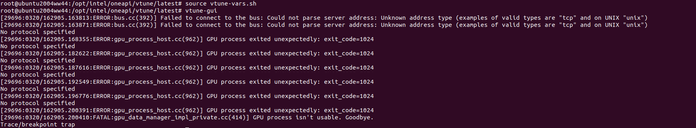

Add screenshot of the problem:
I need the Vtune to run in root mode so it can test application that requires super user permissions.
Any ideas?

Thank you for posting in Intel Communities. Could you please share with us the following information to investigate the issue from our end?
a. Are you able to run Vtune as a non-root user? Or is the issue happening only when you are signing in as root?
b. We could see you are trying to open vtune-gui from root. Could you please try running any analyses using command line from root?
Eg:
vtune -collect hotspots -result-dir r001hs -quiet /home/test/sample
For other vtune command line syntax, please refer the vtune command syntax user guide
c. Could you please confirm whether your system has GUI support?
d. Could you please share with us the self-checker logs output? To get self-checker logs, please refer verifying vtune profiler installation.

So I managed to run the vtune within the command line (as root-user) and then I tried to open the result with the GUI of vtune and it failed because the file was written with root-user permissions so I had to change it and only than I could see the result.
This workaround solved the issue but it is very complicated and takes a lot of time.
How can I open the vtune gui with as a root user?

For a. question: I did run it as a non-root user and it works but the application i'm using requires specific permissions that only super user has.
For b. I will try tomorrow and will reply if it works/
For c. Yes the system does support GUI, as I mentioned before it works with the GUI as non root-user.
For d. Yes I will as soon as I will try to run it again in GUI mode with root-user.

Sorry for the delay in response. As a workaround you can try the following steps. We built an application in root mode and we were able to profile in non-root mode.
STEPS FOLLOWED
1.
echo 0 | sudo dd of=/proc/sys/kernel/yama/ptrace_scope
While trying to profile an application, built in root mode, in non-root mode, data collection would not start because the scope of ptrace system call is limited. To enable profiling, please set /proc/sys/kernel/yama/ptrace_scope to 0(as above). To make this change permanent, set kernel.yama.ptrace_scope to 0 in /etc/sysctl.d/10-ptrace.conf and reboot the machine.
2. Create a shell script appending the executable (application to be profiled built in the root mode) with sudo
##Script.sh##
#! /bin/sh
sudo ./hello  //hello is the executable built in the root mode.
3. Make the shell script executable.
chmod +x script.sh
4. Run the profiling using the shell script executable.
vtune -collect hotspots -knob sampling-mode=sw -- <path to script>/script.sh
Hope this helps.

Sorry for the delay, this is a security feature:
install as root -> login as root and use.
install as user -> use as user
If this resolves your issue, make sure to accept this as a solution. This would help others with similar issue. Thank you!
