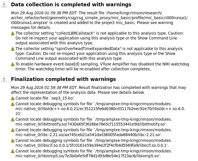

I have a follow-up question. I my custom profiling analysis, vtune seems to have ignored some metrics and do not report the values in the Caller/Callee page, although the metrics' name indeed appear in the Analysis Type panel.
L1_DATA_HIT_INFLIGHT_PF1
L2_DATA_READ_MISS_CACHE_FILL
DATA_PAGE_WALK
LONG_DATA_PAGE_WALK
L2_VICTIM_REQ_WITH_DATA
SNP_HITM_L2
How to solve this issue? Is this related to any of the warnings below, such as the first two pieces?
Thank for your comments.
Dmitry_P_Intel1
1,326 Views
For custom event analysis by default VTune uses HW Events viewpoint that simply shows event values on summary and grid views including caller/callee. First of all - if you look at summary pane - do you see all the events that you set in hardware events table?
