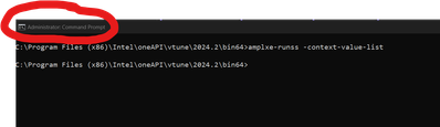

Can you capture the log again using the administrator?

It is strange. From your log on the left in the screenshot below, I didn't see the administrator absent. On the right, you can see the administrator absent even when I open the console window, not as an administrator.

Could you confirm if you run the command line as administrator?
