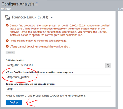

This  is the program I am running on the Linux server, which just prints output every two seconds.
Please see the photos below, which records the entire process of me using the VTune Profiler to analyze. When I started the analysis, it ended quickly, and the analysis results showed as empty. However, at this time, the program running on the remote Linux server was still running.
Step 1:Configure WHERE
Step 2: Configure WHAT
Step 3: Configure HOW and Start
The Result is :
I have already logged in to the Linux server using the root user via SSH, but when I try to use VTune Profiler to analyze the application remotely, regardless of which analysis mode I choose, a black command prompt window flashes briefly and the data collection ends quickly, resulting in an empty analysis report. However, when I use the VTune Profiler's built-in sample (matrix) to analyze locally, there are no issues.

JaideepK_Intel
1,987 Views
We are able to run your sample successfully without any issues on our machines
We assume the sample you provided is not compute intensive to provide enough data to collect by the Vtune, please look to go through the below attachments.
Please provide below details:
  • Windows(host) os: 10/11 .. etc
  • remote Linux distribution : rhel8/7, ubuntu18/20, suse17 ...
  • Linux kernel details (uname -a)
  • both host and remote machine processor details.
Possible workarounds:
case 1:
Rename the vtune installation directory path as shown below and redeploy.
case 2:
try to run with a different sample (Fibonacci: https://www.geeksforgeeks.org/program-for-nth-fibonacci-number/) choose n>40.
case 3:
Please add "fflush(stdout);" after printf statement in your code.

yongchengYan
1,960 Views
Thank you for your answer. I think I have solved the problem. When I run Intel VTune Profiler in non-administrator mode, I cannot collect data for remote Linux programs. When I run Intel VTune Profiler in administrator mode, I can collect data. I don't know if this is a bug, and I suggest that you actually test whether the same problem exists. If running Intel VTune Profiler requires administrator privileges to analyze remote Linux programs, can you consider adding a clear prompt? Thanks again for your answer, and best regards.
