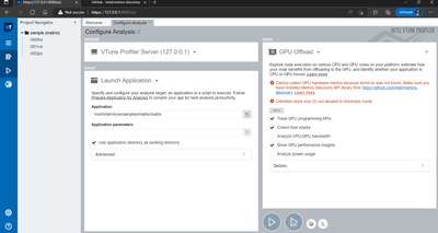

I've downloaded and install the oneAPI base toolkits and using vtune 2022.2.0
I use 5.15.39(with CONFIG_DRM_I915_LOW_LEVEL_TRACEPOINTS=y)
sudo ./prepare-debugfs.sh

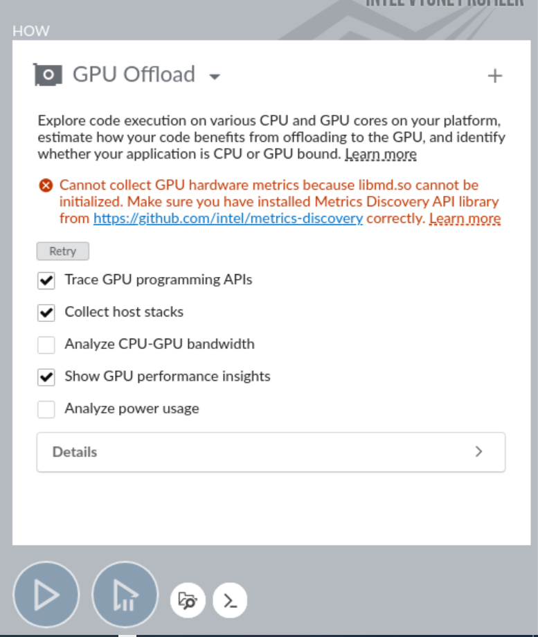

and when open vtune (even with preload sign) when select GPU compute/media hotspot, The Error Occurs: Cannot collect GPU hardware metrics because libmd.so cannot be initialized. Make sure you have installed Metrics Discovery API library from https://github.com/intel/metrics-discovery correctly. Learn more
 I checked amplxe-runss --context-value-list
Driver does not support the 0x4680 PCI ID.

Jia3Xu
3,755 Views
Thanks for your reply!
  • I'm using Ubuntu 22.04 LTS (GNU/Linux 5.15.39 x86_64) on 12th Gen Intel(R) Core(TM) i9-12900K
  • Yes I've tried to upgrade it to 2022.3 with a standalone version but it still does not work. mentioned that I've installed the metric-discovery following the README instructions.
  • blow is the log of self-checker:

Checking DPC++ application as prerequisite for GPU analyses: Ok
GPU HW event-based analysis with runtime tracing
Example of analysis types: GPU Compute/Media Hotspots (characterization mode)
Collection: Fail
vtune: Error: Cannot collect GPU hardware metrics because libmd.so cannot be initialized. Make sure you have installed Metrics Discovery API library from https://github.com/intel/metrics-discovery correctly. See Error Message: Cannot Collect GPU Hardware Metrics help topic for more details.

  • blew are the screenshots.
  •  the log produced by the self-checker is uploaded in the attachment.
thanks for your  help and let me know if any additional info is needed.
JaideepK_Intel
3,725 Views
We were able to reproduce your issue from our end, and we are working on this internally. We will get back to you with an update.
Can you please try on other machines (other than Alder Lake)?
Jaideep
