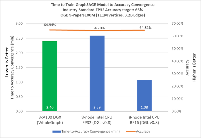

Using these techniques on a cluster of 8 Intel CPU nodes with 2 sockets per node and BF16 as datatype, we train GraphSAGE and GAT models to the target accuracy on the OGBN-Papers100M dataset as shown in Figure 1 and Figure 2.
Figure 1. Time to train GraphSAGE model to convergence. [1]

GraphSAGE: Test by Intel as of 07/11/23. 8 nodes, 2x Intel® Xeon® 8480+ per node, 56 cores, HT On, Turbo On, Total Memory 1024 GB (16 slots/ 64 GB/ 4800 MHz [run @ 4800 MHz]), SE5C741.86B.01.01.0003.2302100643, 0x2b000190, Red Hat Enterprise Linux 8.7 (Ootpa), 4.18.0-425.3.1.el8.x86_64, gcc (GCC) 8.5.0 20210514 (Red Hat 8.5.0-15), DGL 0.8.x, PyTorch 1.13
