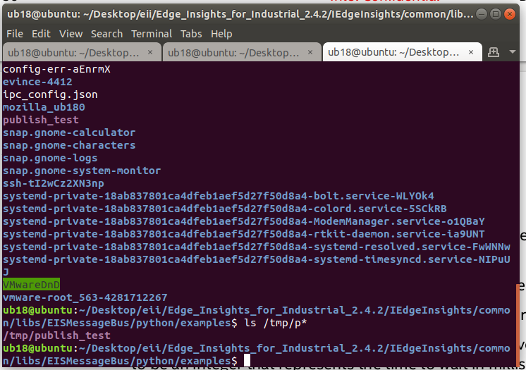

1. EII Message only can be access by ZeroMQ, correct?
2. I try doc( EII2.4 User Guide ) - start from 5.1.
    pub.py and sub.py seems work, and create temp file on /temp
    but I can not see any message.
3. How to access EII message bus information?
    EX: I want to get video inference information
           after detection picture(base64?) and detection information(box point)
