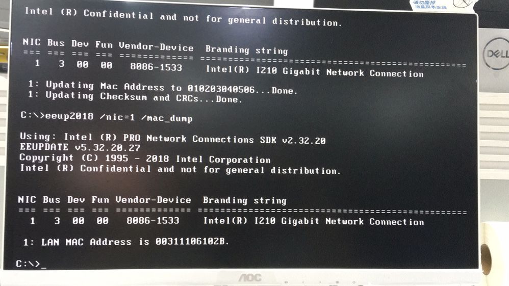

Hi boddy,
     This is my operating environment:
     OS:Win 10 x64,
     IC:WGI210AT
     SPI FLASH:W25Q80DVSSIG
     TOOL:DOCS EEUPDATE
      There is a problem.I have updating the mac address,and the checksum and crcs already done.But the mac address is not  changed.I have tried mant times,but the resultis the same.Attached photos are below.
      What can I do to change the mac address?

Hello, @Teddy:
You should review that your implementation fulfills the requirements that may answer the questions 2.25 and 2.23, on page 9 of the Intel(R) Ethernet Controller I210/I211 Frequently Asked Questions (FAQs) document # 335346. It can be found when you are logged into your Resource & Design Center (RDC) privileged account on the following website:
http://www.intel.com/cd/edesign/library/asmo-na/eng/335346.htm
