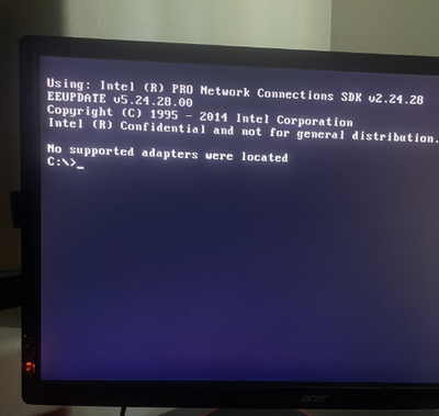

To start here is the situation
Motherboard : MSI Z390 Gaming Plus (I updated and downgraded bios ver to attempt to fix)
Intel Embedded NIC: Intel(R) Ethernet Connection (7) I219-V
EEupdate Version: v5.24.28.00 (I have tried with other versions but this should be the one compatible with my adapter
Important information:
- I have internet connection in windows
- Windows recognizes the ethernet adapter
- Onboard LAN and legacy support all enabled
- When booting into DOS and typing either EEupdate or /EEupdate /mac <examplemac> I get the same message
"No supported adapters were located"
Do note, on other guides I've seen they go to a screen where eeupdate asks to install when they boot into dos, mine does not. I get asked if I want the European keyboard or US and then go to the screen I attached below. For some reason eeupdate cannot recognize my intel device and I've tried multiple different versions. If anyone could give some insight I would greatly appreciate it.
