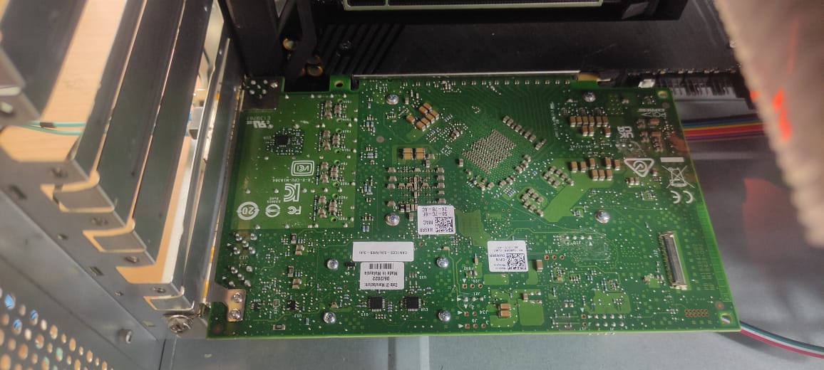

We are checking this case with our internal team. To get a better understanding of the issue, could you kindly confirm the complete model of the Ethernet adapter?
We appreciate your understanding and value your business. We look forward to your reply.
Simon
Munish
8,254 Views
I have attached a image for the same does it work for you.
Simon-Intel
8,244 Views
Hi Munish,
Thank you for sharing the picture of the adapter. Unfortunately, the picture is not clear, so we kindly request that you share a clearer image.
Alternatively, in the document link you shared, we see the Ethernet adapter listed as E810-XXVDA4T. Could you please confirm if this is the adapter in use?
Your prompt response with this information will greatly assist us in diagnosing and resolving the issue as quickly as possible.
Simon
Munish
8,191 Views
Hi ,
I have reattached the images for the network adapter . Hoping that this will work .
I have already shared my major objective for the GNSS module configuration . Please provide and guide me with adequate information.
Simon-Intel
8,184 Views
Hi Munish,
Thank you for sharing the requested details.
Based on the picture you provided, we would like to inform you that the adapter you are using is not an Intel authorized adapter. Therefore, we kindly request you to reach out to the OEM from whom you purchased the ethernet card for further support.
We look forward to hearing from you soon.
Simon
