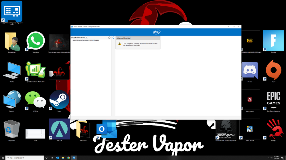

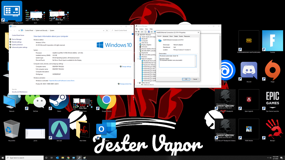

Hello I have Asus Z270E Gaming Board and the ethernet is is giving error of Code 10 Error I have tried every thing please help me with this guys

Please download and run the Intel System Support Utility for Windows and save the report to a file. Then, using the paperclip icon below the edit window, upload and attach this file to a response post.

Have you tried the very latest (v25.0) driver package? It is available here: https://downloadcenter.intel.com/download/25016/Ethernet-Intel-Network-Adapter-Driver-for-Windows-10?product=82186. Download the package first. Then, from the Apps & Features Settings applet, uninstall whatever version of the Intel Network Connections package you currently have installed. Reboot and then install this latest package. Best to do this whole process with Ethernet cable unplugged.

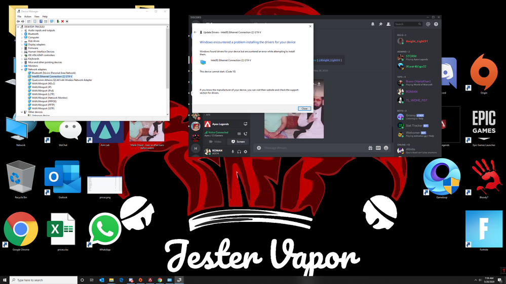

lan 2.pngi have done what you told me sir .. but then this error is showing now ...
Rkhan41
2,136 Views
as you can see the error is still there

Is this device disabled in the BIOS? Check this and also make sure that the latest BIOS is installed and that the BIOS configuration is reset to defaults (you can customize it again once this is resolved).
