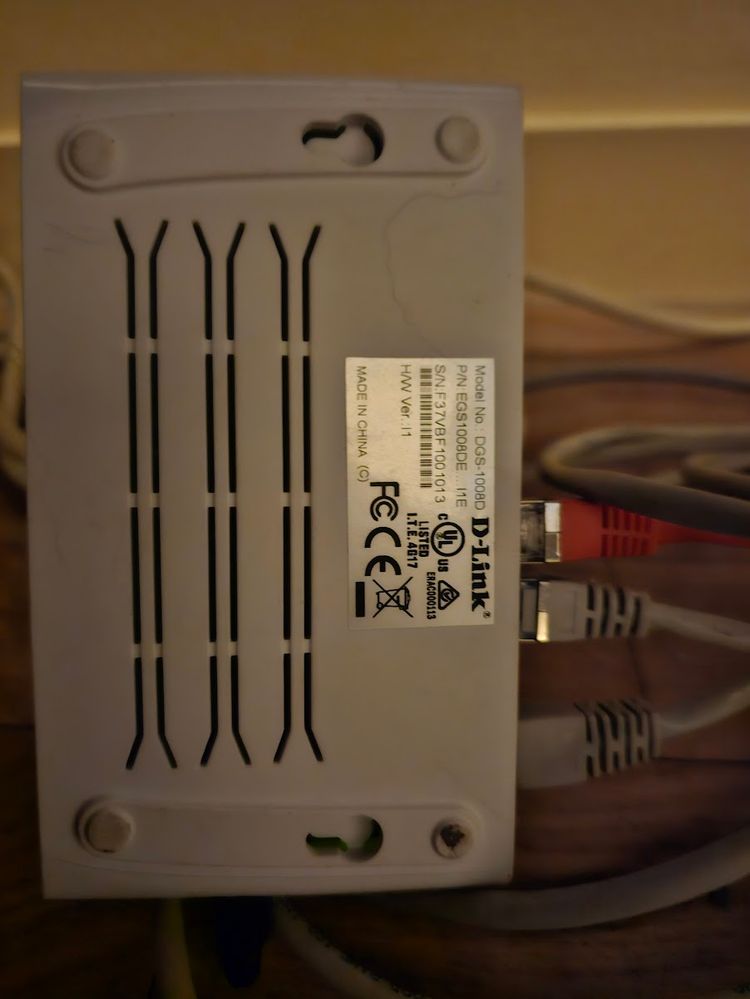

Hello.
Could you let us know what is the switch model that you are using in your environment?
Thank you.

My switch model :
