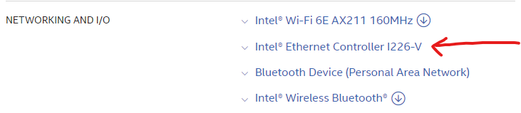

Can someone link to me to the latest driver on Intel's website for the Intel(R) Ethernet Controller I226-V?
I've looked everywhere on Intel's website for the drivers and they do not exist: https://www.intel.com/content/www/us/en/support/products/210588/ethernet-products/gigabit-ethernet-controllers-up-to-2-5gbe/intel-ethernet-controller-i226-series.html
I even tried downloading the 29.0 Ethernet Package and it is not listed nor does it work. https://www.intel.com/content/www/us/en/download/15084/intel-ethernet-adapter-complete-driver-pack.html
I even ran the Intel® Driver & Support Assistant application on my computer and it still does not provide a link next to the ethernet driver like the other components (see below):

As you've observed, the release notes indicate support for i226, but upon thorough examination of each folder and file, as well as reviewing the release notes and setup, it's evident that i226 is not supported in the download file. @Cam__Intel Can we get some clarification why it's not included.
The drivers for I226 are available in the Complete Driver Pack download. They are not called out specifically with a container for "I226", but they are in the PRO2500 container/folder.
If you open the .inf file listed below you will see I226 support.
Download the Complete Driver Pack
Unzip the file "Release_29.0.1.zip"
I226 driver files are contain in the following folders:
Release_29.0.1\PRO2500\Winx64\W11 (File: e2fn.inf)
Release_29.0.1\PRO2500\Winx64\NDIS68 (File: e2f.inf)
Release_29.0.1\PRO2500\Winx64\WS2022 (File: e2f.inf)
I hope that answers your question.

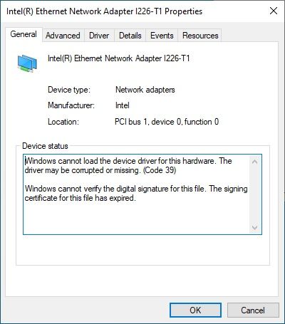

Hello.
His WS2022 folder since version 28.3 is rotten.
I installed it on Windows Server 2022. Look at the diagram below. It's not working.

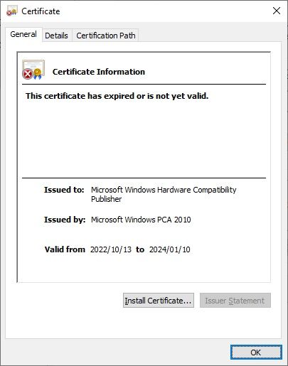

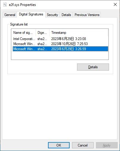

I looked at the properties of e2f.sys in Explorer. You can confirm that you are using an expired certificate. Can it be used normally even if it contains an expired certificate?
[Original Japanese text before Google machine translation]
こんにちは。
バージョン 28.3 以降の WS2022 フォルダーは腐っています。
私は、Windows Server 2022 にインストールしました。下図を見てください。動作していません。
エクスプローラーで e2f.sys のプロパティを見てみました。期限切れの証明書を使っていることが確認できます。期限切れの証明書が含まれていても、正常に使えますか?
