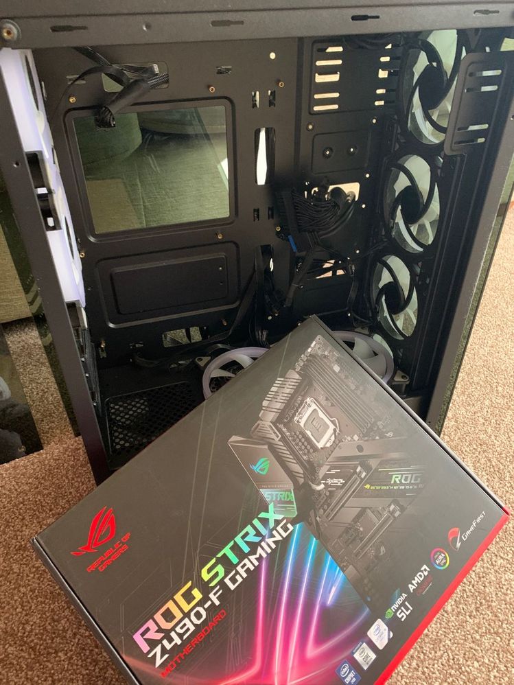

Okay board has arrived - time to get this fitted back in and Tested.
