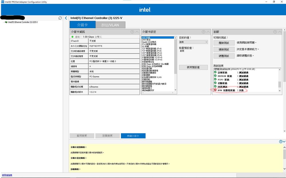

Dear,
About e2fexpress ID:27:
You have replied that 「The Warning is a Microsoft Windows Event that shows up when the network is temporarily disconnected or Windows perceives there is a Micro-disconnect.」
Your Suggest that I go to ask Microsoft and ASUS how to solve it, right?
OK,But ASUS has called me to ask intel that how to solve it two months ago?
Then there are still these problems, and no solutions have been given!
Intel(R) PROSet Adapter Configuration Utility 26.6.09:
1.NVM Integrity Status: Failed
2.Cable Quality Status: Failed => I tried changing the network cable, but actually changing the other one didn't solve it!
3.Cable Integrity Status : Failed => I tried changing the network cable, but actually changing the other one didn't fix it!
Then please can you really give a solution that can actually be solved, without losing or closing the functions that should be there, and under the premise of not reducing performance and stability!
And the above is not a case, there are other consumers like me, the interesting thing is that the Cable Integrity Status item also shows 225 meters!
Note:
The shared router is ASUS RT-AC58U, Chunghwa Telecom's FTTH, and the cables are CAT5E & CAT6!
Thanks!

Hello Orz,
Thank you for the patience.
Please see below feedback from our engineers.
As much as we want to assist you, this may not be a hardware related but an OS related issue because Windows perceived that there was a disconnection and generated an error however the disconnection was never encountered. Since no disconnection occurred, we still suggest to contact Microsoft.
About your follow up questions, possible that this is only false positive because having these errors will cause intermittent or permanent disconnection which you never encountered. It is still best to contact Microsoft so they can provide further recommendations.
