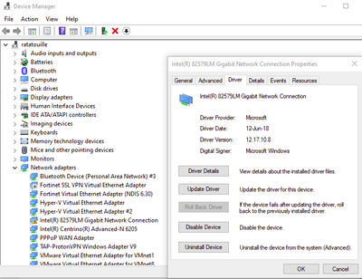

GilF
19,426 Views
The short answer:
No.
Longer answer:
Steps take:
Removed the device from the device manager, and deleted the files referenced by it, rebooted.
The device then appeared with a warning that the drivers were missing (as expected)
I ran the 25.4 installer and got the following:
I that ran the update driver from the device manager, pointing it to the directory to which I extracted the drivers. It was still not recognized.
I ran the update driver using windows update, and a driver was installed. I could then install the 25.4 with no problem, but I am still getting the errors once vLANs are configured.
