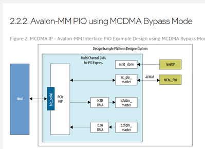

I am using MCDMA R-Tile Design Examples for Endpoint.  https://www.intel.com/content/www/us/en/docs/programmable/683517/22-4/mcdma-r-tile-design-examples-for-endpoint.html
on https://www.intel.com/content/www/us/en/docs/programmable/683517/25-1/avalon-mm-pio-using-mcdma-bypass-mode.html
in figure 2 below Mem_PIO is mapped to BAR0. in my design since BAR0 is used as config area I need to write an RTL to monitor RD/WR traffic to "MEM_PIO"; and  to do that I need access to AVMM agent port`s copy.
for example
  1. BAR 0  offset  0x0 to 0x10h  is my config area.
  2. Host copies "input data" at  BAR0 offset 0x100h to 0x200h.
  3. host writes 0x1h to BAR0 offset 0x0h (part of config area) this means that data between offset 0x100h and 0x200h is valid and my design can use these input data to generate output data.
  4. Output data is copies to unique offset in BAR0.
as you can see at step number my RTL design need to monitor accesses to BAR0, I can only write my RTL if i have access to AVMM agent port activities.  I need to know
  1. What BAR0 offset is accessed by host?
  2. is it read or write access?
  3. if its write what value is being written?
My RTL design can only work I have copy of all accesses. My RTL design is not trying to intercept AVMM traffic or modify AVMM request or responses by any means. Its just looking at the activities and take action for internal logic when needed.
So how do i get access to AVMM agent port?
