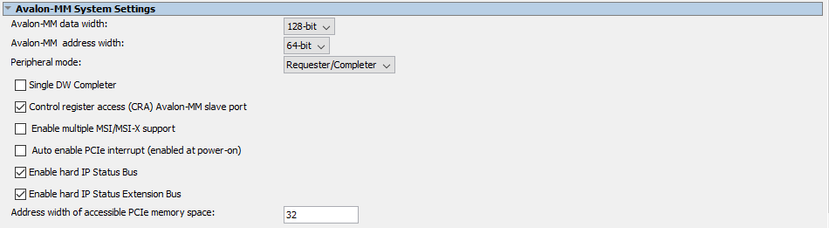

Final update:
We were never able to get address translation to work so I changed the PCIe Avalon-MM address setting from 32 bits to 64 bits.
From this:
To this:
This change eliminated the Avalon to PCIe address translation and the DMAs into external CPU memory across the PCIe bus began to work immediately.
