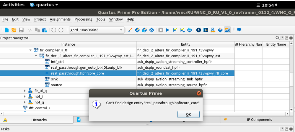

Instance "dl_data_top|dl_data_path_ant1|dl_rf_intf|fir_ul_q|fir_compiler_ii_0|fir_deci_2_altera_fir_compiler_ii_191_t3vwpwy_ast_inst|real_passthrough.hpfircore_core" instantiates undefined entity "fir_deci_2_altera_fir_compiler_ii_191_t3vwpwy_rtl_core"
If I click the Hierarchy, then it did show Can't find design entity "real_passthrough.hpfircore_core"
But when I click the File, the file "fir_deci_2_altera_fir_compiler_ii_191_t3vwpwy_rtl_core.vhd" does exist

RDC
1,697 Views
Just offering some additional snapshot for comparison.
Here is the FIR IP in the original project which can be synthesised, where the "real_passthrough.hpfircore_core" in this FIR IP is defined.
When I add new FIR IP, error message occurs as the previous post.
And the "real_passthrough.hpfircore_core" in the new FIR IP is undefined.
Not sure if I need additional setting for IPs.
Thanks.
