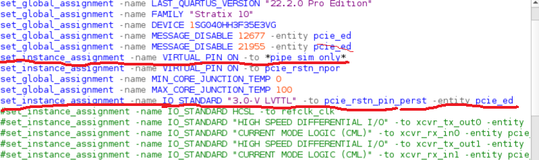

Hi Arley,
Can you try to
set_instance_assignment -name VIRTUAL_PIN ON -to *pipe_sim_only*
set_instance_assignment -name IO_STANDARD "3.0-V LVTTL" -to pcie_rstn_pin_perst
ensure pcie_rstn_pin_perst is whatever this port is called in your top level.

Hi Wincent,
I just confirmed that both constraints are present in my QSF.
Additionally, the pcie_rstn_pin_perst pin is connected to the top level interface.
I have attached the QAR file here.
