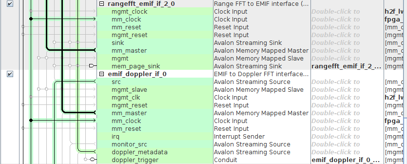

anonimcs
New Contributor III
1,201 Views
Yes, the generation of HDL was done successfully. I attached some screenshots taken from the Platform Designer to this reply.
