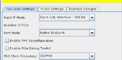

      We are trying to run ptile pcie in end_point mode + user_logic, but during timing analysis "coreclkout_hip" the one generated by HIP ( hard pcie_ip core) and fed to user_logic , is not visible in the "all clocks report"
what would be the procedure to enable this?
In Gen 3 1x8 256 bit with 250 Mhz mode, Quartus is not able to automatically detect this "coreclkout_hip" and do the timing analysis of user_logic that's synchronous with respect to this clock

  • We generate the intel Ptile ip with our custom logic instead of PIO, and these are the following ports, which are given below Adithiya_R_0-1753255402366.pngAdithiya_R_1-1753255426354.pngAdithiya_R_3-1753255767207.png
    rx/tx_pma_parllel_clk, ref_clk these are the only list getting visible, coreclkout_hip which is supposed to be 350 Mhz (gen4) or 250 Mhz(gen3) is not in the list
  • Requirement : To perform timing analysis with respect to coreclkouthip or the corresponding port in custom logic (user_clk)

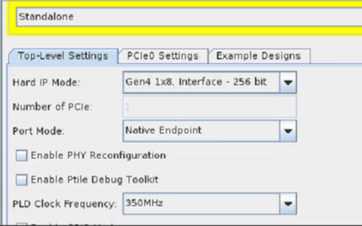

    PLD_CLOCK_FREQ will eventually reflect as coreclkout_hip, is it  ?
   if this is the setting , then user_logic ( bar_access fails ) ---- So suspecting this freq_change is causing some issues , for which we need timing_analysis wrt coreclkout_hip or user_clk
And sof is working perfect for Gen3 and not working for gen4 where PLD_CLK_FREQ is the only change. why is that ?
--Yes
--Probably the user logic part is not able to run correctly at 350MHz.

    Yes, our user logic is unstable at 350 MHz.
    To figure this out we need to enable the Timing analysis with respect to Coreclkout_hip
    That clock is not seen in the timing analysis. How to enable that?
RongYuan
658 Views
Testing a PCIe Gen4 1x8 350MHz PIO design in Q25.1 Pro, the coreclkout_hip can be seen at the pio side as below screenshot. You may find similar clock input for your user logic.
Another two 350MHz clocks from dut|dut|inst|Inst|maib_and_tile are from a pcie wrapper file already constrained in pcie sdc files.
