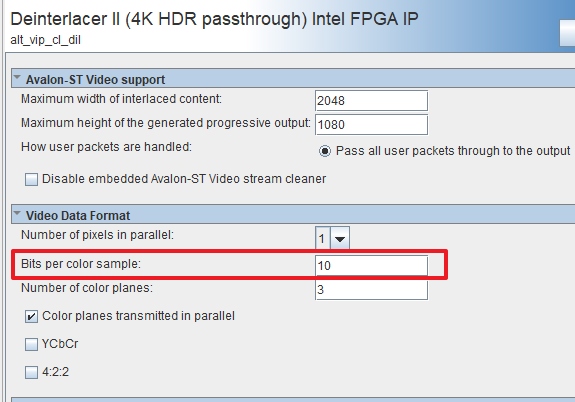

deinterlace II ip ,when i select 8bit or 12bit of color sample, my program is working properly, but when i select 10bit, is abnormal. The input is the same
I am not sure what colour format that you use. Have you try with different color format input ?
Are you using latest Quartus version else you can try upgrade to latest Quartus version to see if the issue still persist ?
Also you can try out different deinterlacing algorithm to see if it make a difference
Thanks.

Unfortunately we don't have the example design.
Intel FPGA doesn't offer v18.2. I presume you are referring to v18.1.2 ?
To rule out potential old Quartus version issue,
- pls try to upgrade to latest Quartus version if possible.
- Since it's working on your colleague PC, you can install v18.1 on your PC to see if it's v18.1.2 version issue but I doubt so
Another thing to check is to ensure your FPGA design is timing clean to avoid design functionality failure
Thanks.
