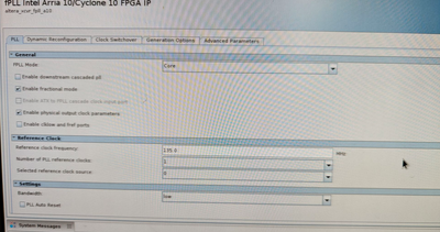

   I am so sorry that I have limited authority that I could not transfer our design to you. But for the fpll design, I could provide the related configuration :
lambert_yu_0-1758769396367.pnglambert_yu_1-1758769416927.pnglambert_yu_2-1758769431762.png
And I think this information could help to generate the related IP. About dynamic logic, maybe you need to re-design.
