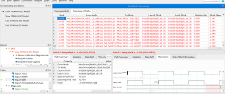

  I am checking the design with ddr3 interface, nios processor and other interfaces also in cyclone v gx device(5CGXFC5C6F27C7). I have given memory clock as 400 Mhz(ddr3 ip parameter setting) and uses afi_clock(200 Mhz) to connect the clock of other interfaces.
pll_clock of ddr interface is 50 Mhz. connected from the osciallator in the board.
 Nios processor also connected with afi clock only (200 Mhz)
For this design , i am getting pll_afi_clock setup time violation.
i have attached the timing report.
PLease give solution for this.

The setup violations showed in the report are all asynchronous path. You can use 'set clock group' constraint to eliminate the relationship between 'inst|ddr3|pll0|pll_dq_write_clk ' and 'dqs_n[3]_OUT'.

You mean the same violation still exits? Could you show the violation in the timing analyzer which is better to view.
BTW why you put the altera_reserved_tck in the group? I think you don't need to constraint it.
SERMASWATHIKA
4,231 Views
for better view, i have attached the screenshot of violation
TingJiangT_Intel
4,126 Views
There are also synchronization path violation. Could you please provide your project for further analysis.

Hi there, what violation you get, could you please share the path in timing analyzer.
SERMASWATHIKA
3,017 Views
I am getting timing violation for these path
