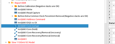

I am checking the design with ddr3 interface, nios processor and other interfaces also in cyclone v gx device(5CGXFC5C6F27C7). I have given memory clock as 400 Mhz(ddr3 ip parameter setting) and uses afi_clock(200 Mhz) to connect the clock of other interfaces.
pll_clock of ddr interface is 50 Mhz. connected from the osciallator in the board.
Nios processor also connected with afi clock only (200 Mhz)
For this design , i am getting pll_afi_clock setup time violation.
i have attached the timing report.
PLease give solution for this.

Just look into the screenshot that you provide, when I try to compile the design and load the PD, I see that you left your avalon pipeline bridge as dangling.
Any reason for that? You can actually connect this pipeline from your CPU.data master to Avalon_pipeline_bridge to TC timing to increase the pipeline for you to close the timing. I would suggest you download one of the example design in the NIOS II in the design store to see how the connection look like.

Besides, this timing violation on the Platform designer, you also have violation on the DDR itself.
Can you create a separate thread to resolve this timing violation for the DDR part? As this will require tuning the DDR setting in your design. thanks
