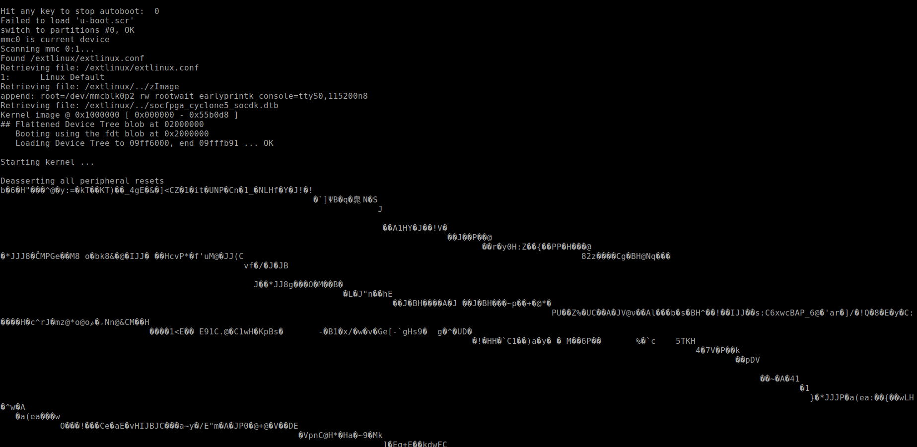

1) PFA debug log images,
Image_1 is when baud in 115200 uboot boot log is visible but as soon as it goes to kernel config then it shows garbage data,
if  baud changed  to 230400 then uboot boot log is not visible garbage data but kernel boot log can be seen after that all system runs on 230400 baud even able to run the application.
