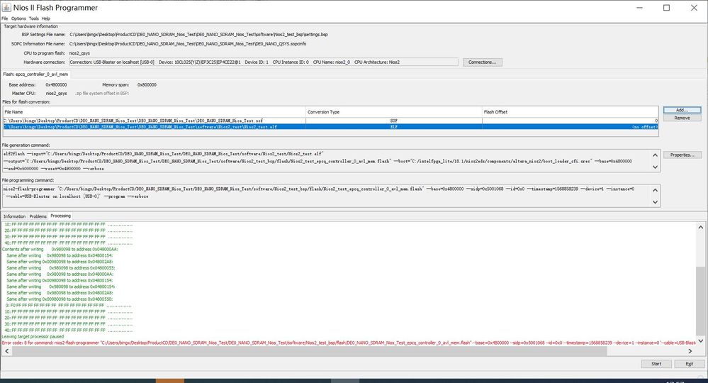

Hi Fawaz,
I tested the attached project with my DE0-Nano board, I had a error when using the Flash Programmer to program the EPCS device, could you help checking the issue? I attached the error information here.
By the way, could you teach me how you generated the .jic file for this project?
Thanks in advance.
