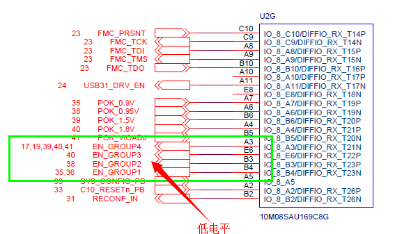

I bought A new DK - DEV - 10 cx220 - A, use website kit through the onboard Micro - USB connection is not on the board, dial the code switch is the default state, use multimeter to check, found that U2 EN_GROUP * for low level, makes the power supply chip board part can not make, doubt is U2 record of the program has A problem, need to burn down try U2 pof file, the website not found, do not know can you provide?

I got in to the link you provided, but the files are not the one I need, This files is for U3 chip(CFG MAX10), I need the files for U2 chip (SYS MAX10).

Thanks for update. FYI, the board team stop providing the source file, we no longer provide the source code U2 chip (Intel MAX 10 FPGA Power Manager) file of system for any Intel Development Kit board. Apologize for any inconvenience caused. For pin configuration you can check in schematic diagram and board layout pcb Cadence .OLB file. Please find package here https://www.intel.com/content/www/us/en/programmable/support/support-resources/download/board-layout-test/pcb/pcb-cadence.html?elq_cid=4171900&erpm_id=2892549
