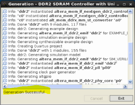

I updated Quartus from 18.1 to 19.1 (standard edition). I can't generate DDR2 controller with UniPhy IP from IP Catalog. A MAX 10 is the FPGA in the design. I did following after installing Quarus 19.1.
1) Installed patch for 19.1 (0.02std).
2) installed Ubuntu 18.04
3) ran the following command successfully.
sudo apt install wsl
sudo apt install dos2unix
sudo apt install make
4) ran wsl successfully
5) generate the DDR2 controller and stuck as illustrated in the captured window.

Hi Sir,
You may refer to this KDB which is related to WSL usage. --> https://www.intel.com/content/altera-www/global/en_us/index/support/support-resources/knowledge-base/tools/2019/how-do-i-install-the-windows--subsystem-for-linux---wsl--on-wind.html
You may check on your OS version whereby the recommended OS would be Windows* 10 build version 16215.0 or higher. Also make sure to follow standard instructions from Microsoft® to install Ubuntu* 18.04. The link on the guideline provided in KDB above.
Hope this helps.
