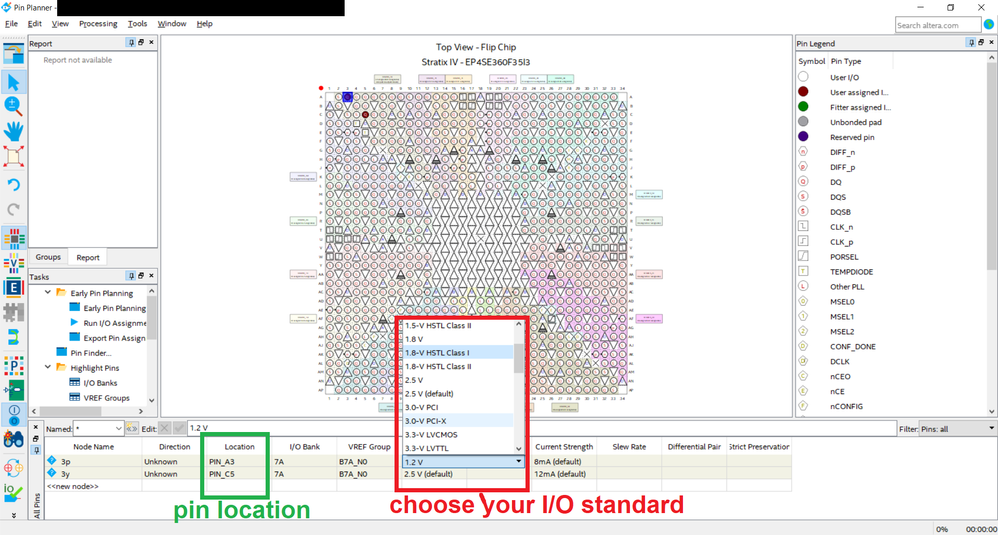

Hi! I have Cyclone10 GX devkit. Is it possible to make a soft start on the output pins? If yes, then how to configure it Quartus 18.0 SE?

Welcome to INTEL forum. Sorry as I read through the description, I am not sure on what is the specific enquiry.
Could you elaborate more what do you means by “Is it possible to make a soft start on the output pins” ? Are you trying to learn how to do Quartus design or learn how to assign FPGA pins in the dev kit board?

I am learn how to assign FPGA pins. Soft start is when the output voltage rises slowly.

Hi Длаза ,
You can use Assignment Editor or Pin Planner to assign FPGA pin in Quartus.
Go to Quartus>Assignments>Assignment Editor/Pin Planner
In Assignment Editor or Pin Planner, you can assign pin location, I/O standard, Current strength and etc.
Below is example how Pin Planner looks like:

If I use "slew rate=0" in assignment editor, then how slowly will the output voltage rise?

Hi Длаза ,
We do not have the value as per your request.
We apologize for inconvenience.
